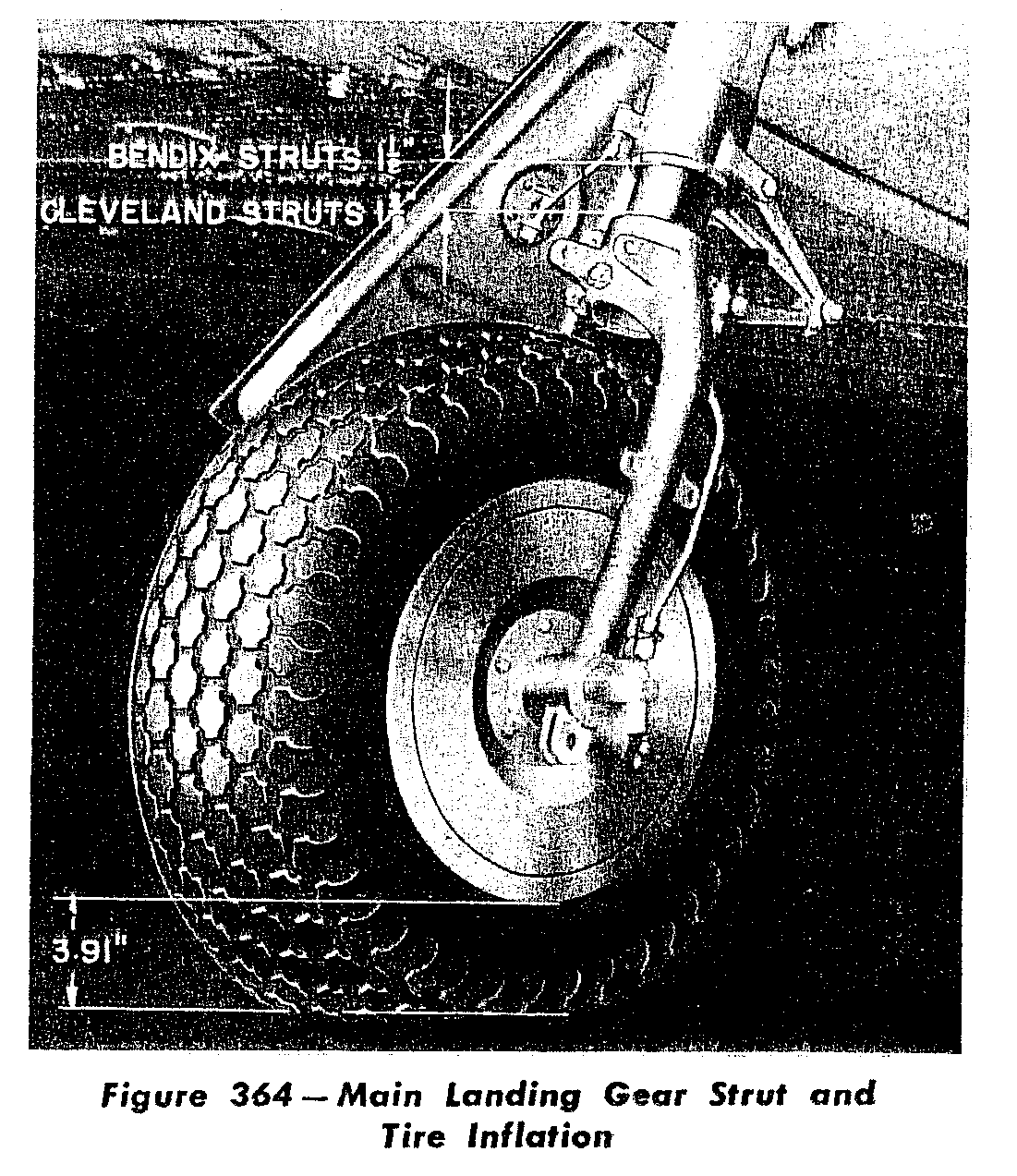

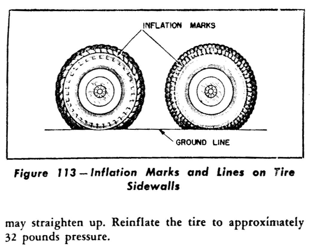

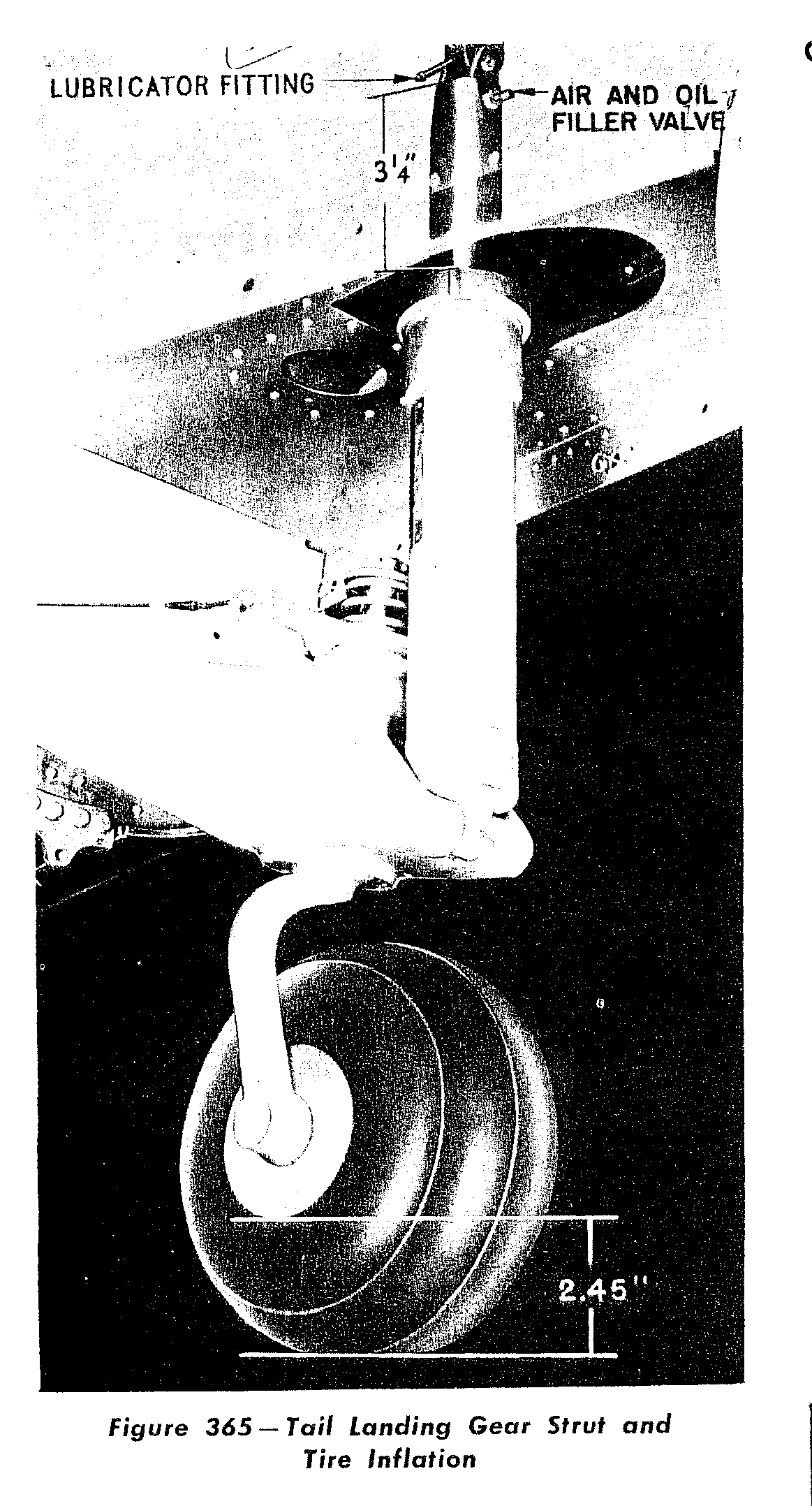

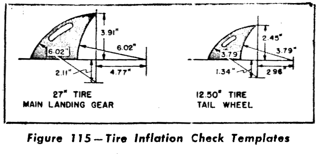

Since I still own all the TMs, here is a pertinent part on tires and proper inflation. Did you know they usually come with inflation marks? If not, you can make your own tire inflation check template to 'point' to the proper height the bottom of the wheel should be. In other words, the inflation check templates measure the height of the tire's sidewall from the level ground to the bottom of the wheel.

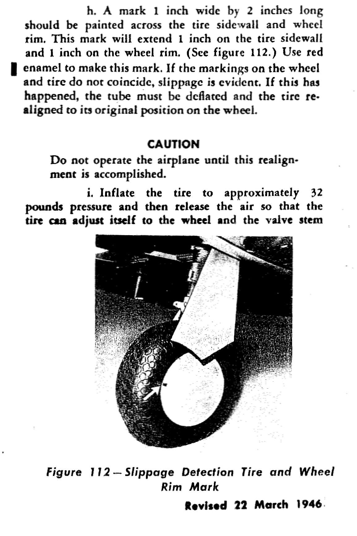

I start this with point H which is about painting a slippage mark in red enamel. In high school, we used good old testors flat red.
If the tire doesn't have the line to indicate proper inflation, make a tire inflation check template:

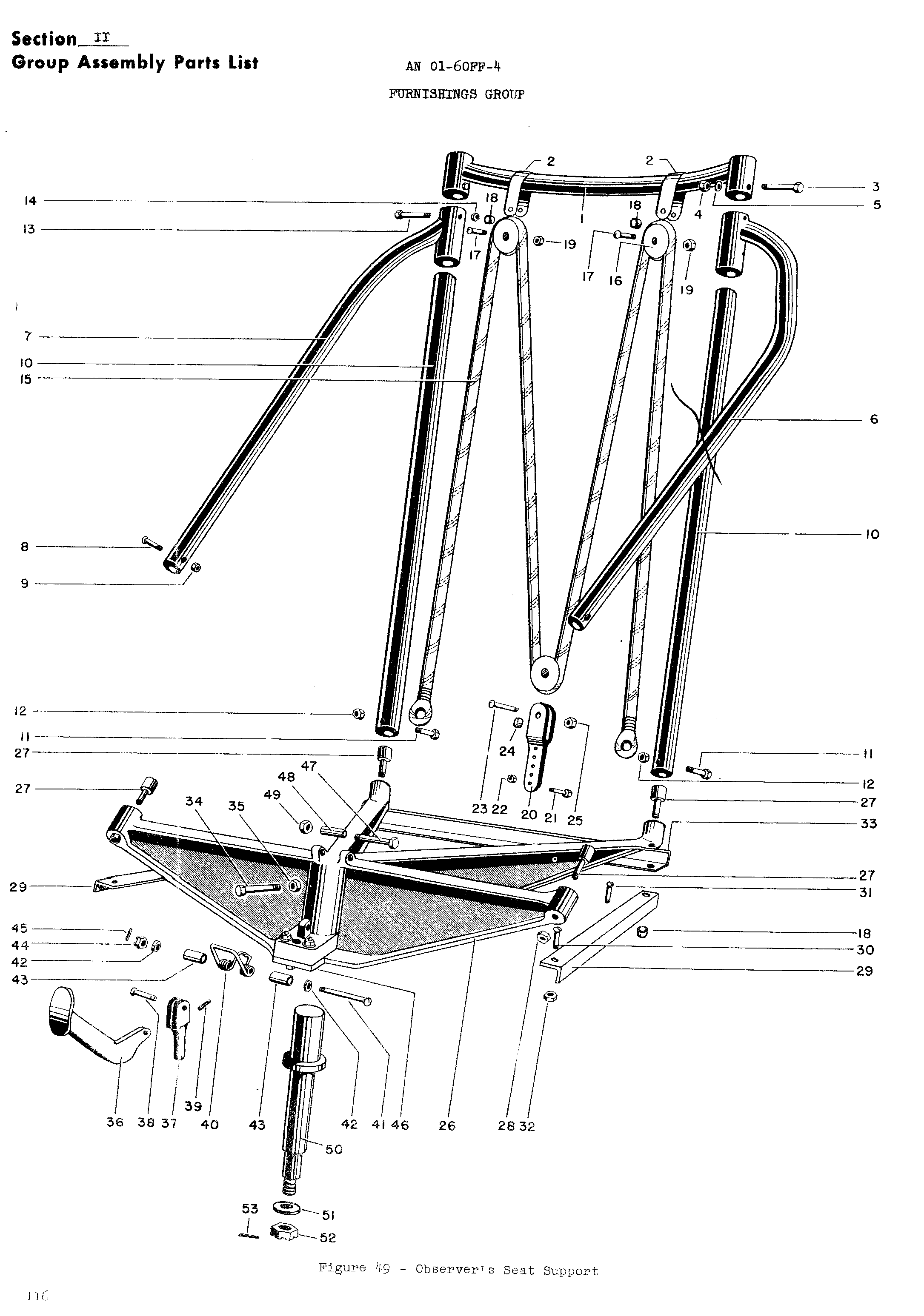

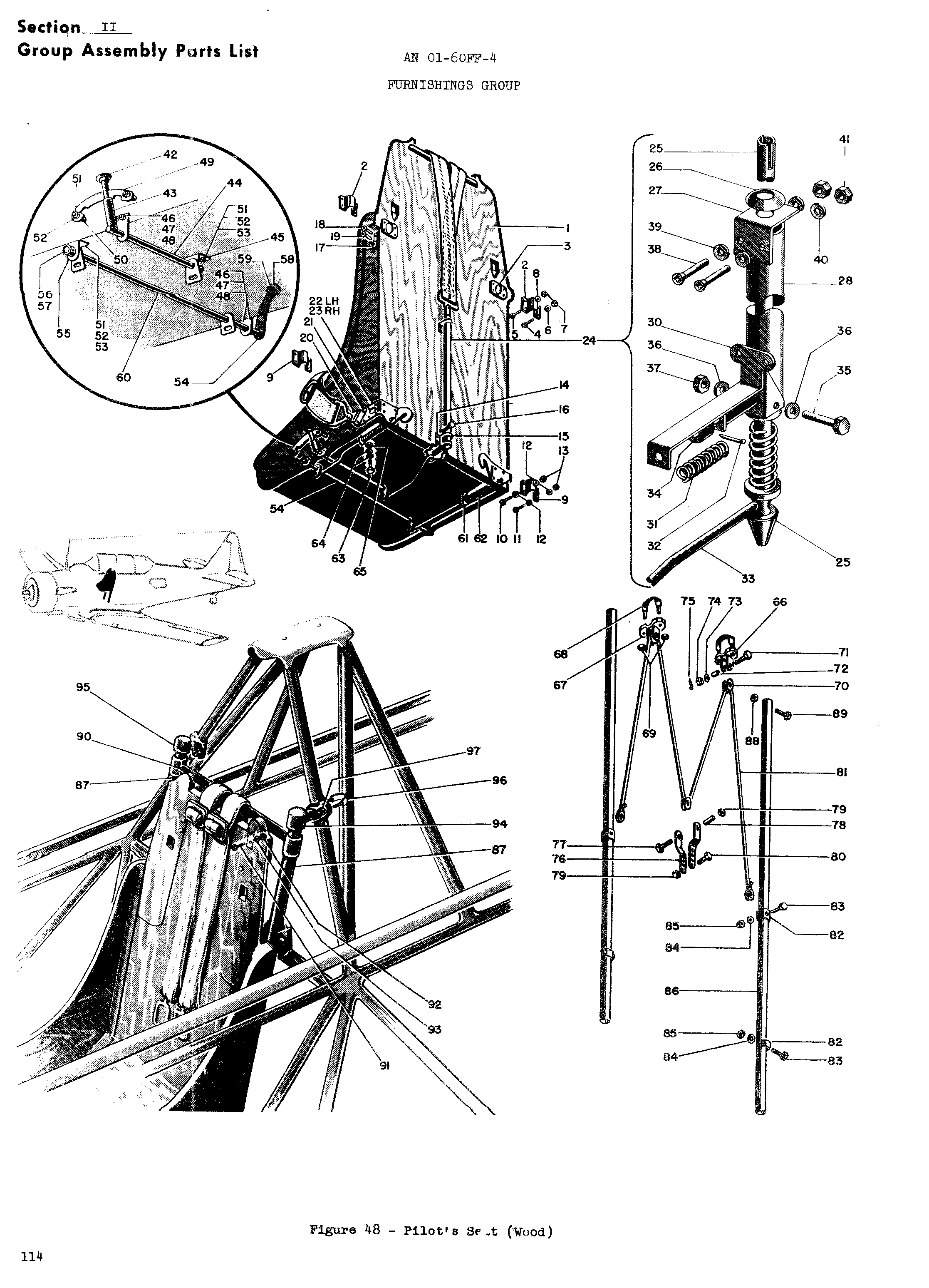

Also, a correction to what I wrote. The SNJ/Texan/Harvard series did indeed use the same seats as the Mustang but it was later on for the trainer. Early models, especially those with the wooden rear fuselage, used wooden seats:
Swivel seat for the observer:

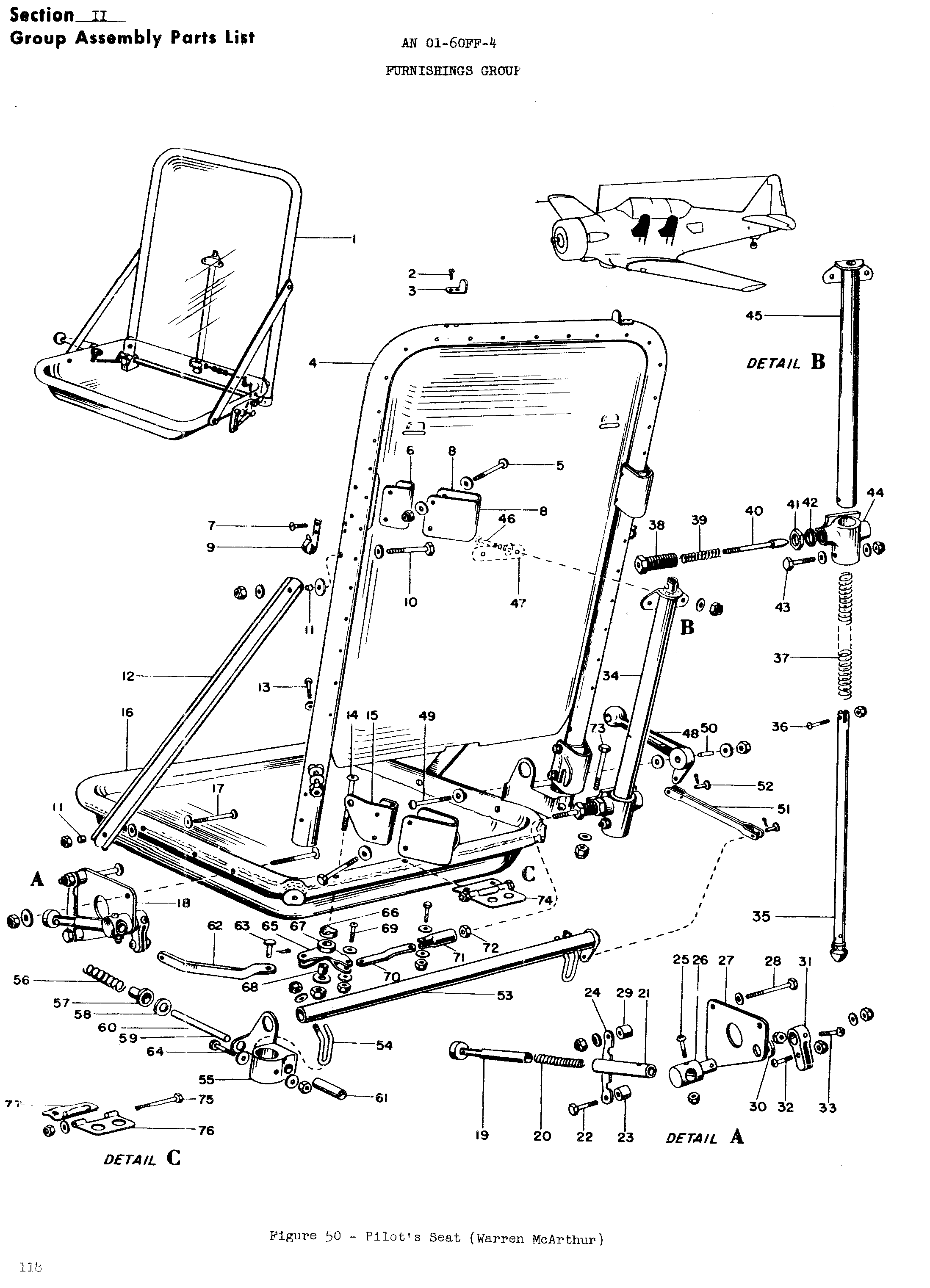

The Warren-McArthur seat as used in the Mustang:

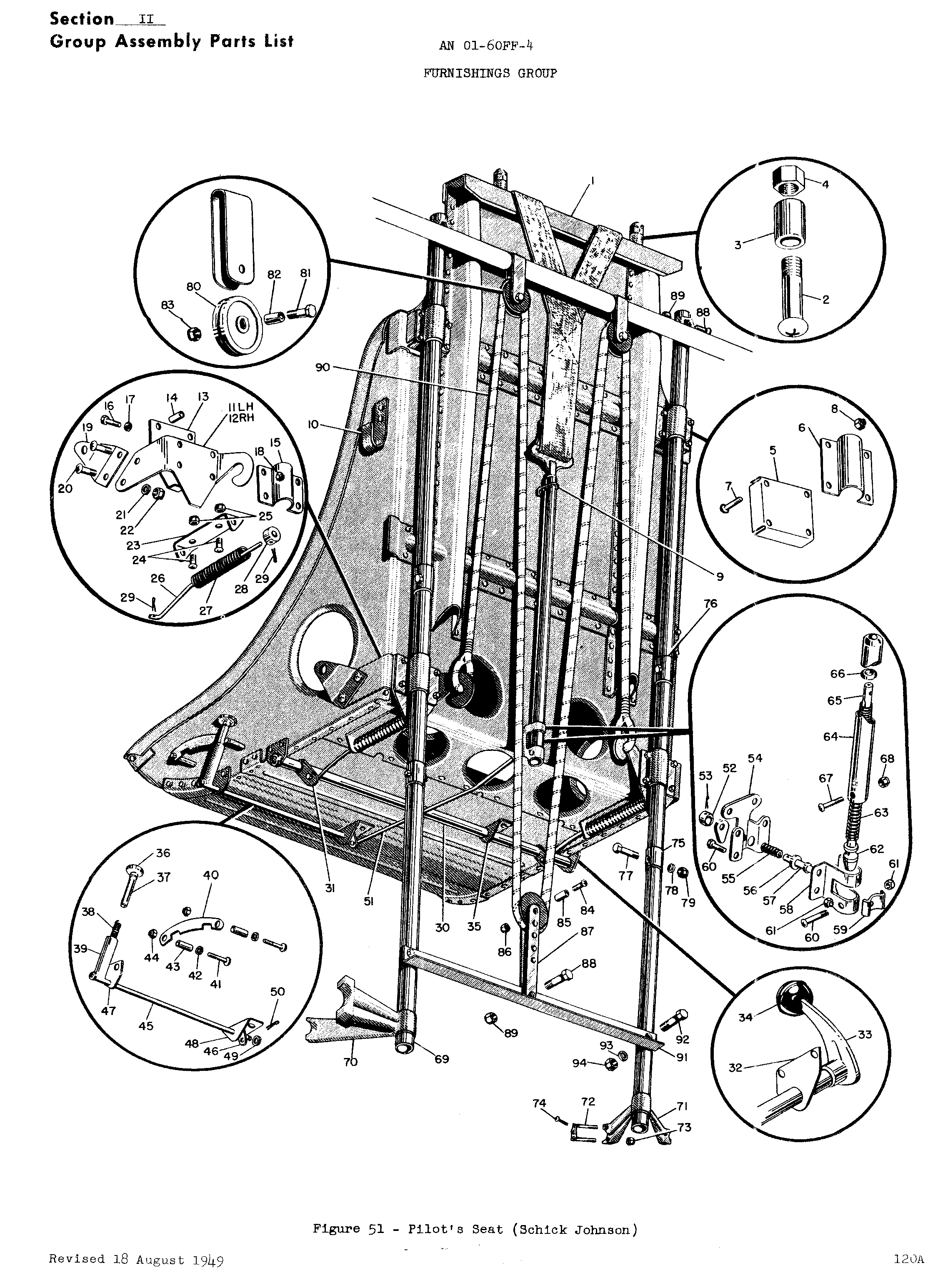

The Schick-Johnson seat as also used by the Mustang:
