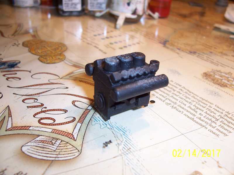

Man there's so much going on around here it's not funny. By the time I get a chance to sit down I'm done for the day. I got in just an hour or so this week, today as a matter of fact. More parts I put in this thing the more I find I gotta do. Started work on the engine and engine bay. Nothing really to show yet.

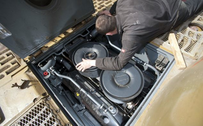

Checkin' out photos of the Maybach, so what color, Black or German Black Green?
I've always painted the German engines black, but who knows for sure? Didn't we all think that Jap Zeroes were yellow until the 70's. Gary S.

Engine color......

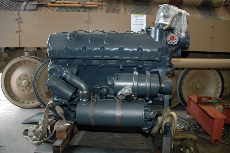

The engine pictured looks like the engine from my Tiger I model. I'm amazed about how small in diameter the drive shaft is.

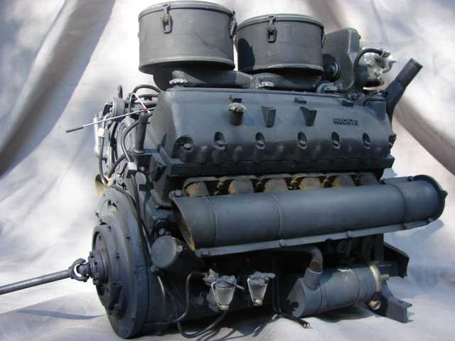

I think this is a Tiger II engine. I've even read in one of my books that the later KT's were painted dark green inside and out. Gary S.
MIG's Ammo interior set has a dark gray for the engines. I've always heard they were satin black from the factory. They gray will look great once its all weathered up.
Something to consider, this engine is rebuilt. It might not be even close to the original color let alone the color it would be after a bit of use and a lot of dust. Have seen a lot of aircraft engine photos and many, if rebuilt or restored, are not even close to the original color.
A good example would be the engine for my T-90 tank. Had several photos of that type engine. Some photos showed it painted red, others it was a medium blue. That is for a modern tank still in service. :hmmm Eventually went with the blue.
Still a great reference photo though.
I tell ya what, if someone who really wanted to go to town on this thing it's got the parts.
So I got the Red Oxide set from Mig to help this out some, it comes with Dark Wash, Neutral Wash, Brick Red and Red Oxide oils and two filters. But no Red Oxide...... :bang head :bang head
